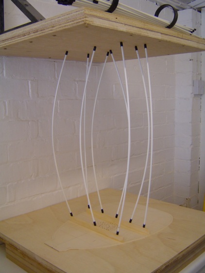

I did the same as Jon, and need to add thickness like Ron's.
Just got my new batch of 3/16" fg rods. The accumulated force from the 1/4" ones when gluing plates was just too scary.

    I was thinking, go-bars could probably be restrained by some light cord attached to one end if it gets too hairy!

I used to have the problem of the occassional go-bar lauching itself across the room if it got nudged. Since I changed the design of my deck I have not had one instance of a go-bar moving when placed on a brace. I found that the main problem was having to reach around the front support posts. My solution was to use industrial strength brackets of angle iron to hold the top to the wall and so keep the whole area clear and easy to move around.
PostPosted: Tue Jun 13, 2006 11:49 pm
Now that is really great, Colin!! It would indeed be an improvement not to have the vertical supports.
